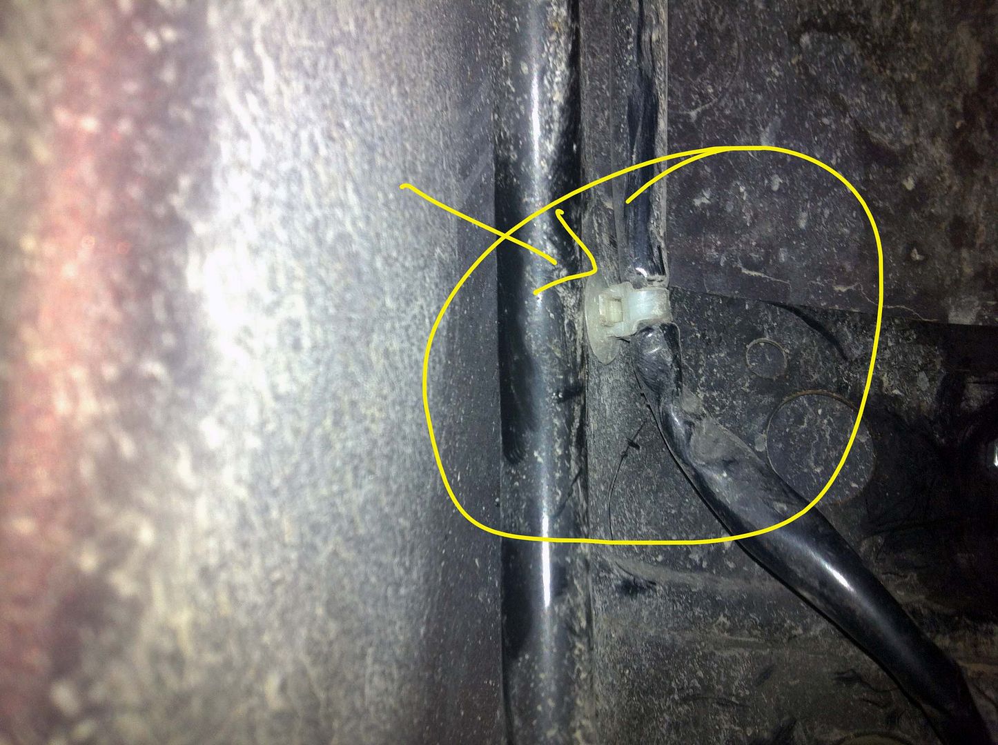

okay newbie doin some winter fun here..I'm pulling off the tail light assembly in order to do a little work on it..add/swap new lights and stuff..now I got the seat off and I see where the light connects to the battery but uh..it seems to be attached to the fender with these little do hickey's! ?/ anyone know what they are and how they come off? cut em? pull em? leave em? I was just planning on unhooking the battery cable atatcment thing and slide it off but nooo couldn't be that easy lol. any thoughts are welcome! thanks ahead of time :)

It is a factory wire tie, it is not glued, or shouldn't be. They have the, I guess you would call wings, on the back that have to be squeezed together for the tie to be removed. Or it can be released with a very small screwdriver inserted above the little tounge like tab sticking out. If you look at your arrow, you can see the flat part that latches it above the tab I referred to, insert small screwdriver in between the two.
