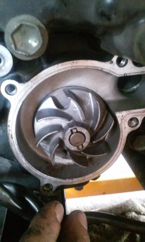

Ok so I still have overheating issues after flush, fill and new thermostat. I am now wanting to check to make sure the water pump is indeed fact pumping so wanted to check the inside out but the impeller isnt lined up with the screws and the impeller only twists about a quarter inch max and still cant see the screws........ Normal?

Anyone know how this is? Or have this happen to them?
You are working against the slot ended drive shaft that turns the pump from further inside the engine.
Rotate the engine counter clockwise using the bolt under the plug on the left side engine cover. The crankshaft must rotate towards the front of the bike at the top of its rotation.
Don't turn the engine over in the reverse direction....
Just rotate far enough to be able to access each of the water pump bolts.

Thanks Gene, is ther anything in particular I should look for when I take it out other than the bearing? Dont know if its not turning but is my only hope cuz I dont have any leaks

There isn't much to go wrong with the water pump except for leakage. The blades on the pump look good.
If you proceed with the removal you should replace the O-rings that seal the outside of the bearing housing or replace the pump as an assembly.
From the look of the pump, unless there was external leakage from the weep hole, you should be ok. With leakage comes eventual bearing failure.
I'd be more suspicious of external rad fin problems or internal tube blockage in the rad that will reduce cooling.
