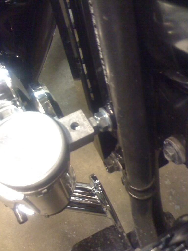

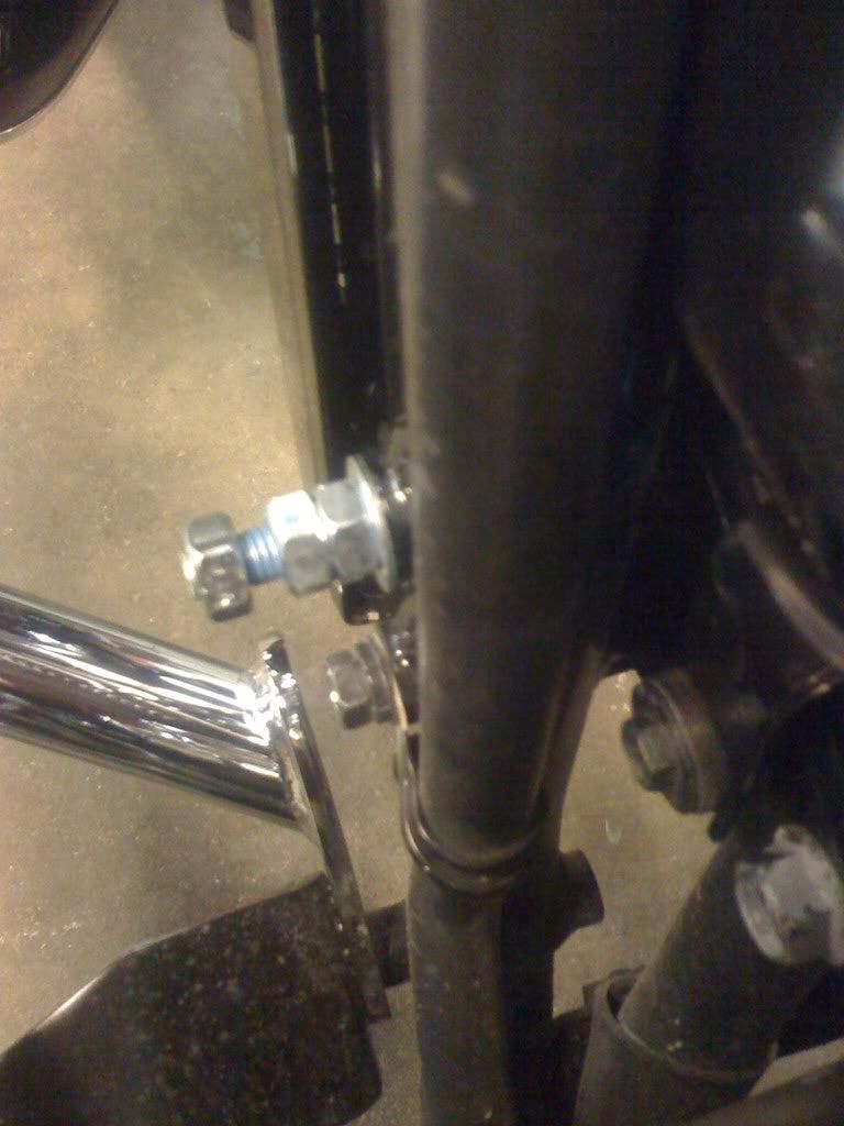

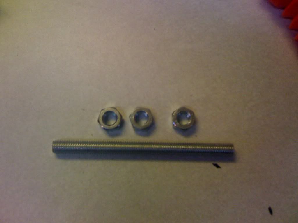

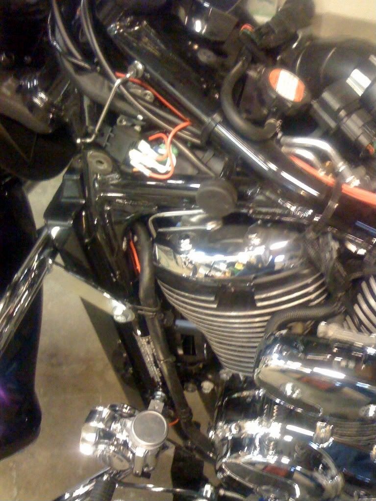

I'll start off by saying thanks to all the previous Stebel posts because it made mine a snap to install. I stopped at the hardware store and bought a metric threaded rod M8x1.25 and 3 matching nuts. I cut it to length, used Loctite and mounted it in one of the lower engine mount bolt holes on the left side of the bike. It was simple and very solid. Sorry for the camera phone pictures. Holy loudness!!!
