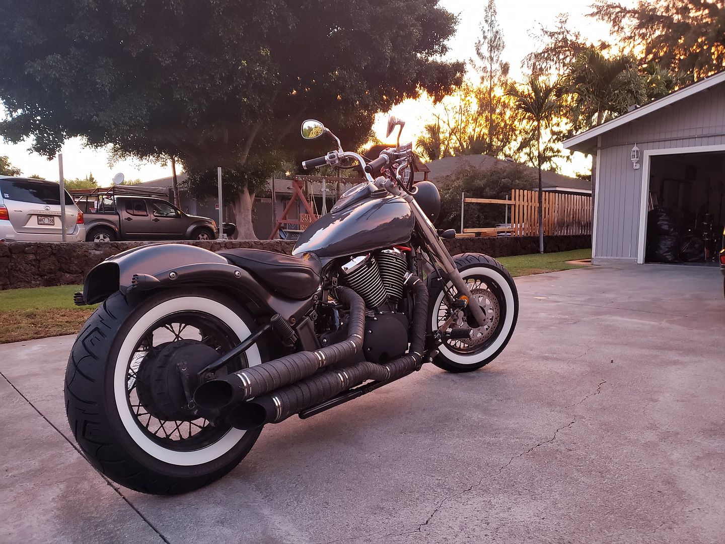

I've been creeping on this forum for a few months with purchase of an 01 Volusia that was beat to hell and this site has been extremely informative. My current battle has been getting the bike to run right after putting in a used engine. (Previous owner said the engine was maintained..right up to when the piston shot out the front of the engine at 70mph. Fun times). I decided to go with the naked jug look, so the bike is de-paired, de-airboxed, k&n carb mount, and also I removed all the EPA crap because with the look I was going for, all the tubes and canisters were just plain ugly. A multitude of issues arose, between the bike cutting out a mile after riding, no top end power, and intermittent loss of power. I'm putting these in bold to help others when they go searching through pages and pages of info like I did.
